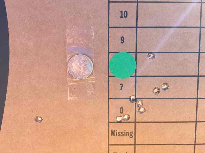

15 yard, off-hand target (bless my shaky, old hands) :)
The wind began picking up...
