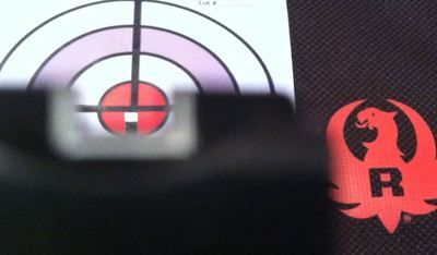

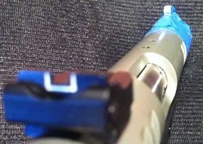

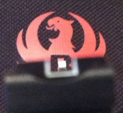

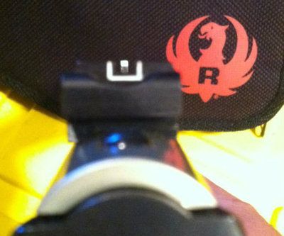

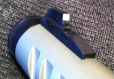

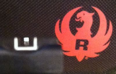

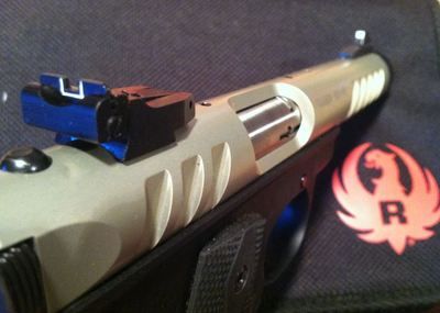

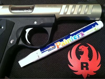

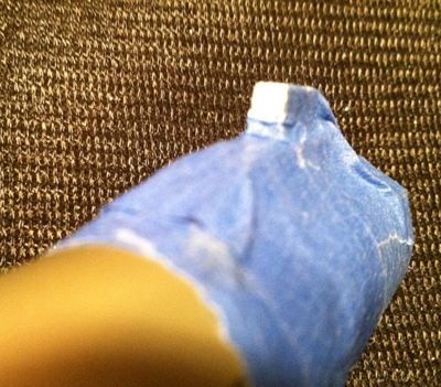

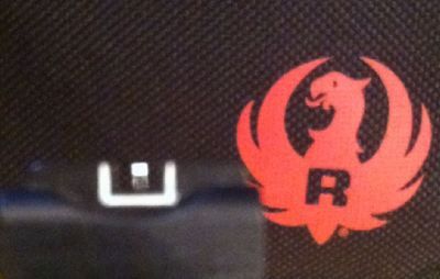

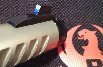

Broke down and did my first modification to the new 22/45 lite. Because I can't find any High Viz sights available yet, I thought I would try a mod I saw ealier on here. Simple enough. Some permanent paint and some painters tape and a tooth pick. The front sight was easy,just taped up around the sight to create a nice square pattern and apply the paint. The rear sight was also easy but required a toothpick to get the paint into the U-shaped groove with out going everywhere else. I'm happy with how it turned out and I think it will be a good improvement until High Viz makes the Lite sights.
A little picture heavy, but enjoy!

Opaque acrylic paint markers. States, Ideal for use on wood, plastic, clay, glass, metal, foam board, fabric, and terra cota. Permanent & streak free. Non-toxic and acid free. Available in Fine and Medium point.
Elmer's Solid Paint Markers are Permanent and Opaque in Bright Colors
As far as the picture size goes...not sure what you mean. They seem normal sized on my iPhone. They are just simply iPhone photos loaded to photobucket. If there is a setting I need to change I'm not quite sure what or where that would be. Open to suggestions.

Did you take the rear blade out to paint? Or just mask and paint using a toothpick on the gun?
Actually on the rear blade I did neither masking or taking it out. It was easy enough and deep enough to just apply a small amount several times to the very tip of the toothpick and swipe it into the groove. I only miss swiped once and it was easily wiped off while wet with a plain paper towel. Because it is a deep groove wiping leaves the paint where you want it while only taking off the flat areas you don't.
Good luck if you try it. I hope it lasts a while without wearing down. We'll see as time will tell.
