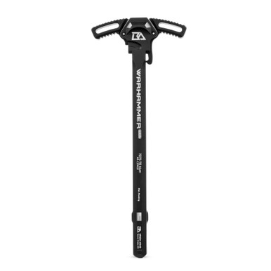

I decided not to use the Breek Arms Warhammer charging handle because it rubs too much when charging the bolt. Maybe it's out of spec. In it's place I used a Presma charging handle. Other than that everything is the same as I listed.

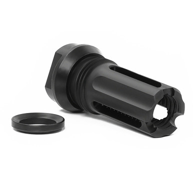

The Breek Arms flash hider has outside threads for a flash can or suppressor.
