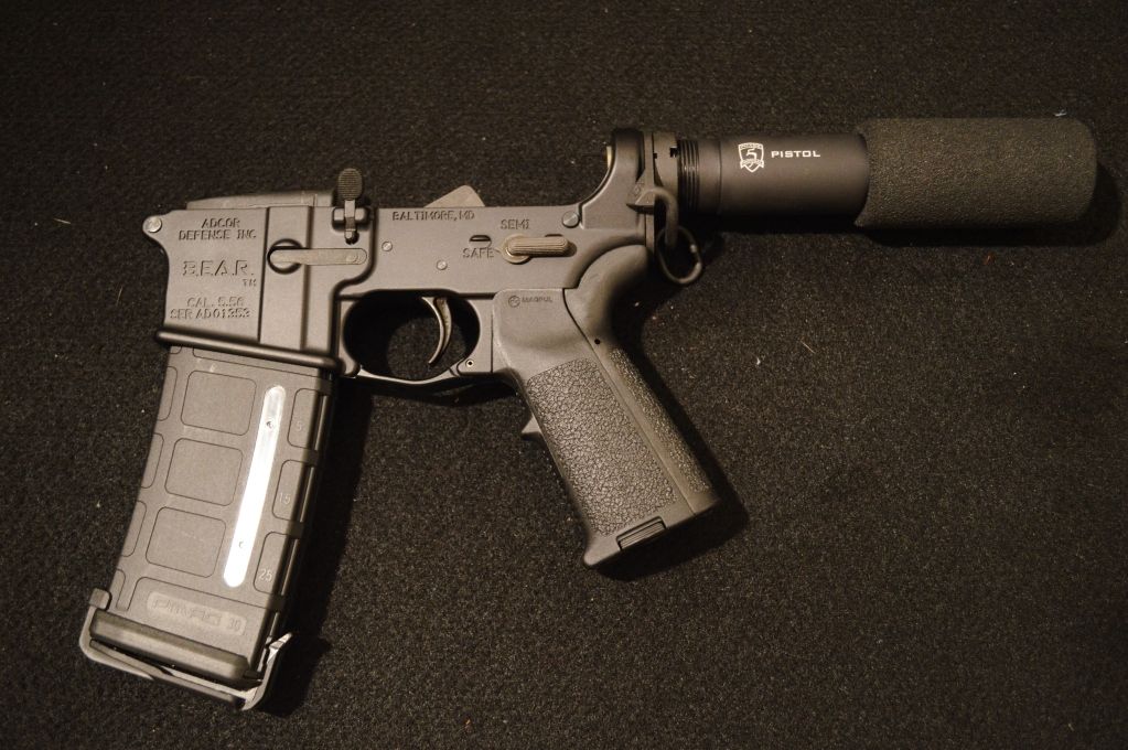

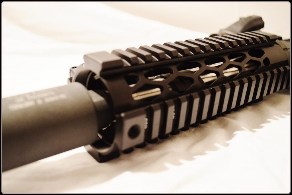

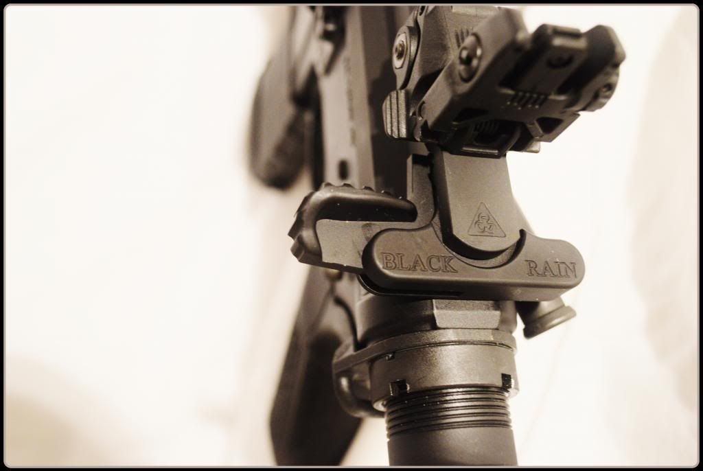

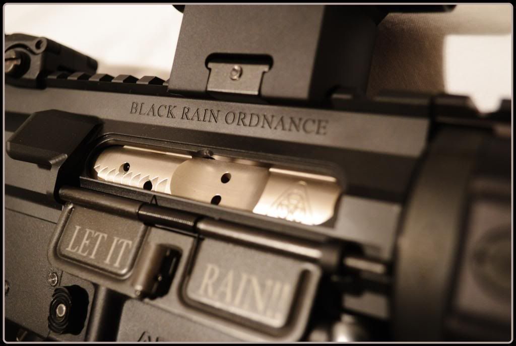

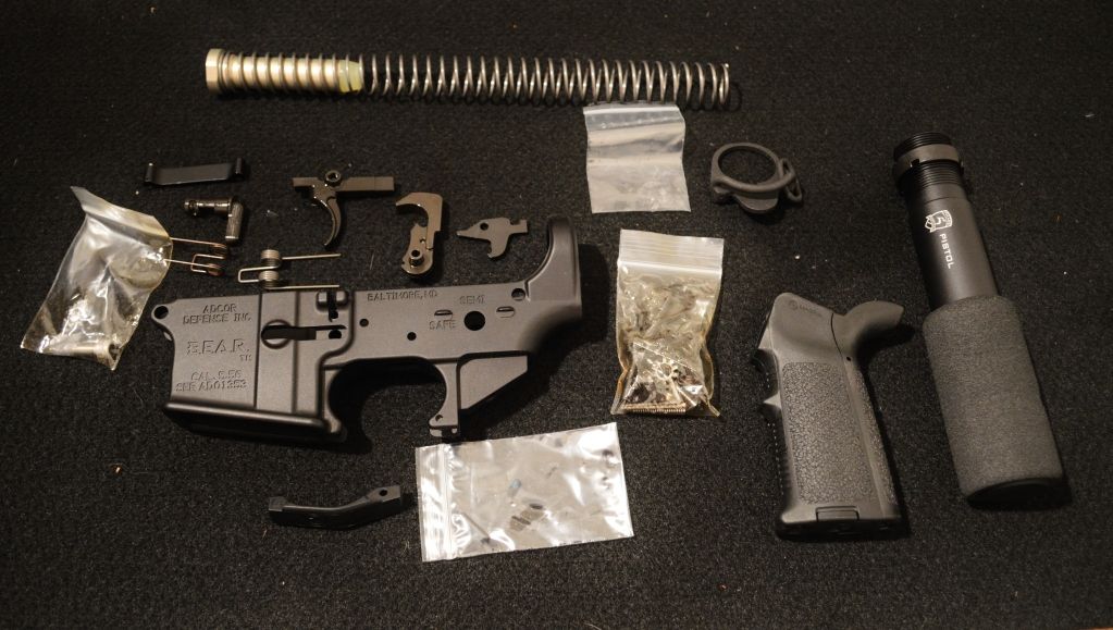

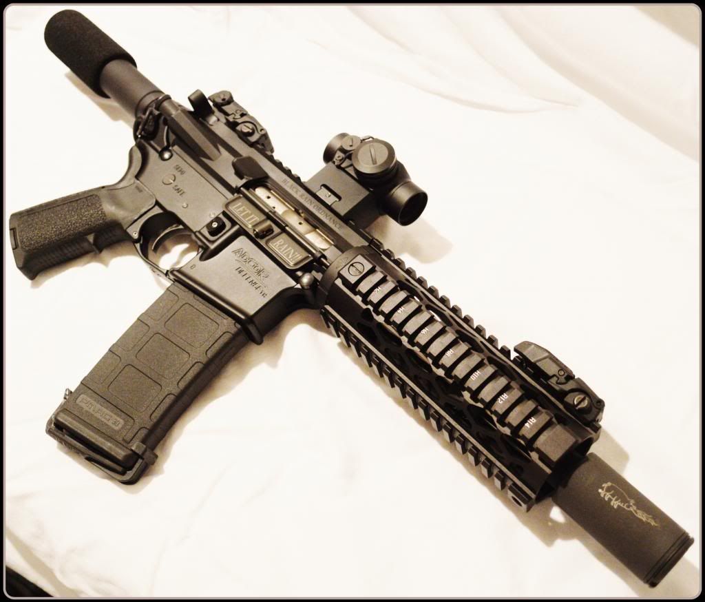

Well, I'm finally done with my AR Pistol build. It will eventually become an SBR but until then, I will enjoy it as a pistol. Here are the specs and a few pics.
Lower:
- Adcor stripped lower
- Spike's LPK
- Magpul MIAD grip
- Magpul ASAP
- Phase 5 Pistol buffer tube
Upper:
- Black Rain Ordnance Billet Upper
- Black Rain Ordnance 7.5" Stainless Steel barrel in 223 Wylde
- Black Rain Ordnance extended charging handle
- Black Rain Ordnance Nickel Boron BCG
- Noveske KX3
- YHM handguard
- Magpul BUIS
- Vortex Sparc

Range report:
Took the pistol out yesterday and put exactly 200 flawless rounds through her. One thing I will say is that the blast and fireball that came out of that thing brought a lot of attention my way. I went in expecting some cycling issues but didn't have a single one. Also, I thought shooting it would be a bit uncomfortable since there is no stock. I was pleasantly surprised how easy the Phase 5 pistol buffer tube made it. It was so comfortable that I have now changed my mind on making it an SBR. I only had 2 issues. The trigger and hammer pins started walking on me and the Vortex Sparc optic started coming loose. I ended up ordering some KNS Anti rotation pins when I got home. As for the optic, I need to make sure I used the right size screws and put some loctite on them. I'll look into that this afternoon. Overall, I was very pleased with this build. I didn't bring my camera but here is a snapshot on my phone of the fireball :D
