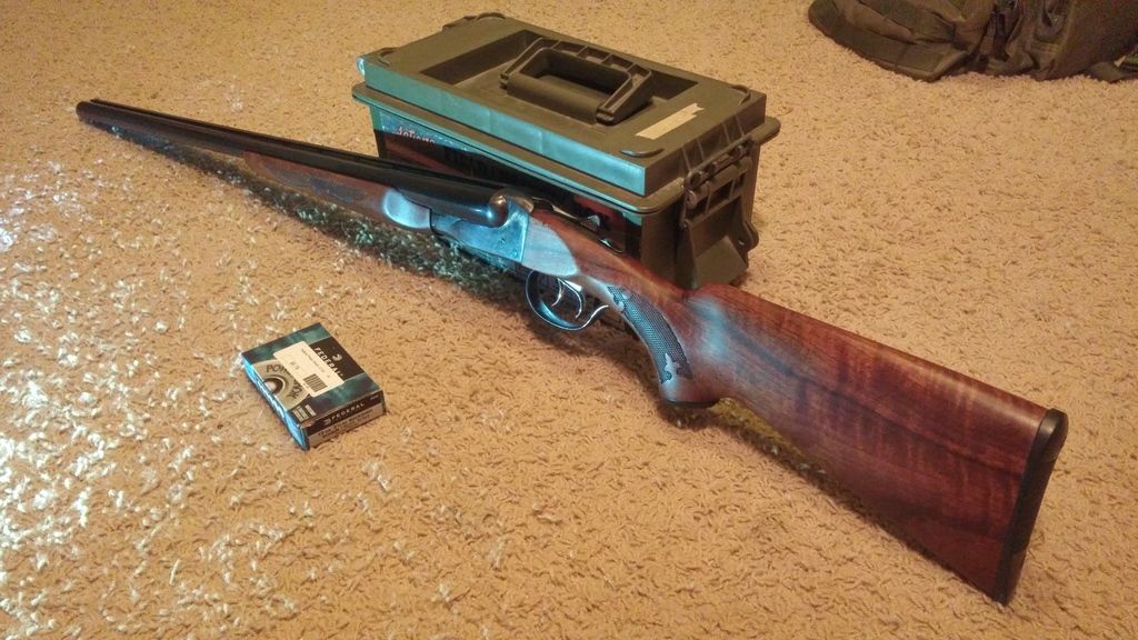

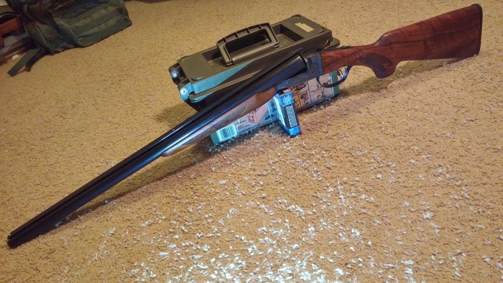

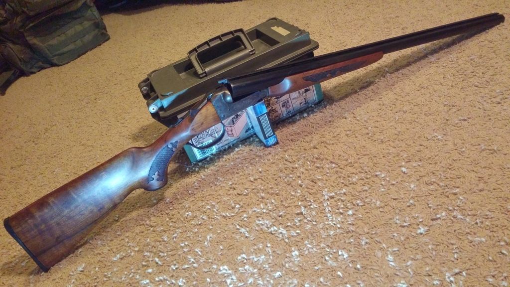

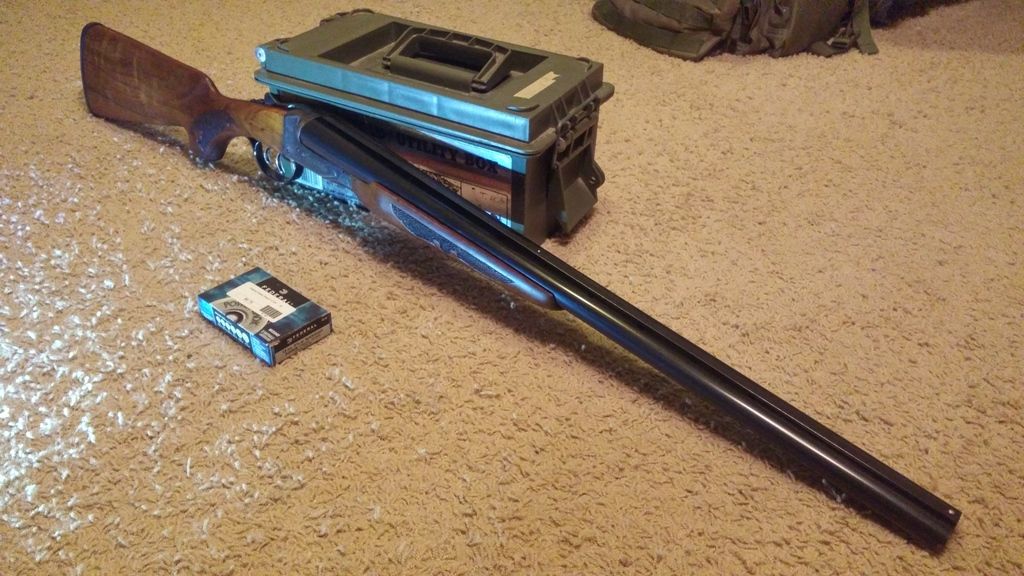

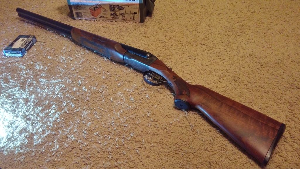

The Fox... I finally got around to re-finishing my late grandfathers shot gun that has been passed down to me. It is the first shot gun I ever shot, and the first gun that earned me a gaggle squirrels on my first hunt with my dad when I was a kid. It is a early 1960's Savage Fox Model B 12ga. shot gun SxS, and still runs like a champ. In fact, it was made before they start putting serial numbers on firearms. They called it the "working man's double barrel." And I tell ya what, any working man would be proud to call this fire arm there own, even Joe Biden. :D

Yeah most of the Foxes I've seen go up to the 700 dollar range for one in good condition. But this shot gun is a hand-me-down, I would probably get struck by lightning if I get rid of it. But it has held up pretty good. The case harden steel and barrels are rust free, the stock and forearm were weathered so I sanded them down and re-applied layers of boiled linseed oil for the finish. But if anything breaks on it I will send it to the best surgeons ;)

You have a very nice side x side shotgun & you have done a great job on refinishing the gun stock. Well my only shotgun currently is a over & under 410 gauge shotgun that I bought about 3 years ago. Thanks for sharing pics!!!

How many coats of linseed and did you sand or steel wool between coats?

I've got 4 layers so far, and it gave the wood a nice satin glow. But I use 0000 steel wool, a slightly damp paint thinner rag, and a dry foam sponge between applications. Wool to open the pours, a rag to wipe off the dust, and wipe down with a dry sponge to clean any excess dirt of the stock before rubbing on another coat of oil.
