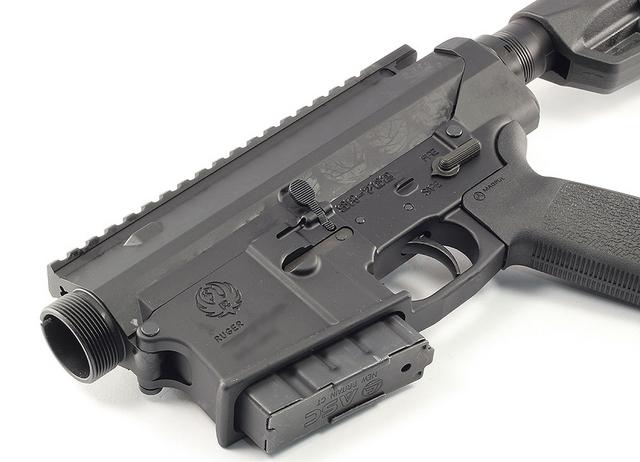

So one of my gun buddies is building a .308AR and I accompanied him to the gun shop to look at his options. Anyway, while he was hemming and hawing about all the options, I was admiring all their .308 offerings. They had a few Ruger SR-762s, ubiquitous DPMS, LWRCs, etc., then I saw they had the new Stag 10 rifles, including complete and stripped uppers/lowers.
Just for kicks, I asked the clerk to mate the SR-762 lower to a Stag upper.... and it fits. Takedown pins line up nicely however the receiver profiles especially at the rear don't match up but there were no gaps. (Side note: looks like the Stag upper receiver "could" mate up nicely with an Armalite lower with the narrow flats on the side). With a complete Stag upper mated to the SR-762 lower (sorry no pix), from what I could tell it functioned correctly where I could charge the bolt back, engage the bolt hold open and released it, hammer felt like it was striking the firing pin correctly (dryfiring was discouraged...oops -- did it 3x, hehe:D). Machining on the Stag receiver looks nice and it's threaded for a DPMS barrel.
The clerk wouldn't let me take pictures with my cellphone but after slipping him a Hamilton he took some for me on their light table but only with a stripped upper (see below):
CMA (cover my a$$): I'm not stating for a fact that Stag uppers will work with SR-762 lowers but it does indeed fit -- that much I do know for a fact.

I was inspired (actually kinda jealous) by my buddy's new .308AR rifle build and decided to build a custom upper for my SR-762. After researching the interwebz and reading through the epic threads here on rugerforum, I found out that Matrix Aerospace makes the SR-762 uppers and lowers for Ruger. On Matrix's website they only sell matched upper/lower sets, so I called them and they will sell you a stripped upper by itself. But with my google-fu skilz :D, I found another source for a stripped upper that was more economical. Anyway, the upper arrived yesterday and here it is mated to my SR-762 lower:
Woohoo! Perfect fit and looks exactly like the upper that came with my SR-762. Now, excuse me, but I've got some shopping to do to finish out my build. I'm thinking of putting on a longer barrel for sure. Any suggestions for barrel, handguard, etc., is appreciated.
