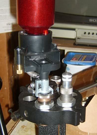

Hey Creepy now tell me if I am wrong but you can see the powder when you charge a shell can't you? A fellow ask me that the other day and I didn't know the answer. I have never seen one set up and running. Thanks.
yup, when you pull the handle down the bar in the auto disk moved twards you to the drop tube and the you can watch the poweder fall from the bar and as you lower the handle you can see the powder in the case again, you have to be sitting about level with it of course good overhead light makes it easy to spot.
maybe these will help, first is no brass, 2nd pic is brass flared/charged

OK Creepy I see what you are talking about. Thanks a millon for giving me pictures and all. Made it real easy to understand. Have a good day. Baldy.
no problem pics are always better than how i can describe it lol
