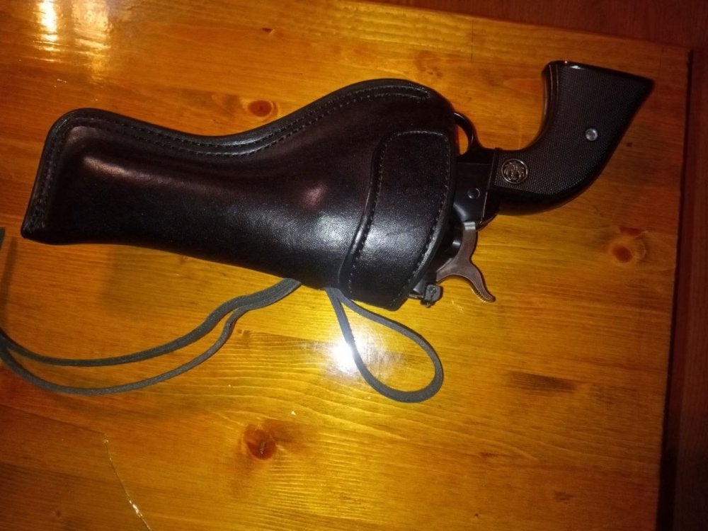

R.S. You have a conventional Blackhawk so it takes XR3-RED grips. These are the most common grips that fit Blackhawks, Single-Sixes and short barreled Super Blackhawks so you shouldn't have a problem finding them.
