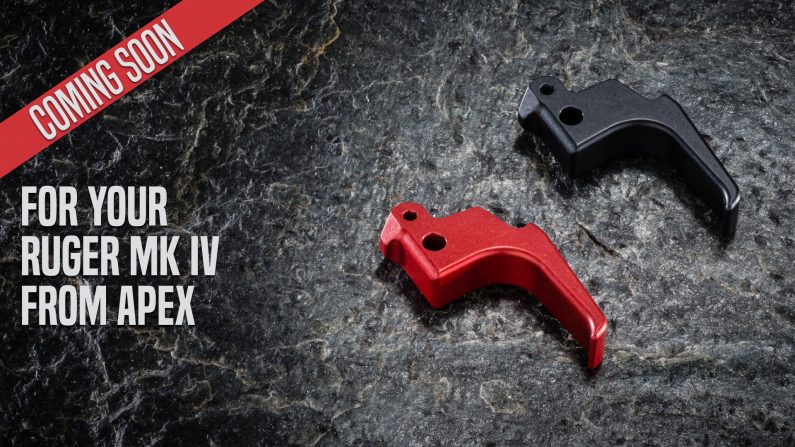

Lot's of trashing going on here for a trigger that nobody's even tried yet.
Triggers are just simple levers. The ratio of the arm length below the pivot pin (where you pull) to the arm length above the pin (where the sear pulls) determines how much leverage it produces. For normal "curved" triggers, this ratio is about 2.5:1. For flat triggers, this ratio is about 3.5:1. So the flat trigger will produce about 30% pull reduction where your finger can pull near the bottom. Your pull gauge can pull at the bottom where it can register nearly 40% reduction.
It's unfortunate that Apex decided to advertise pull weights on this front page. If you dig back into the material further, they do advertise 40% reduction. This trigger being the only change to pistol having a factory 5.5 pound pull and achieving 3.5 pounds is actually pretty good!
I would be willing to give this trigger a try. But I would want just the trigger for around $40, not the entire "kit" for $90.
The only advantage I would see to the Tandemkross trigger would be the pre-travel adjustment screw. Using the Apex trigger would be a LOT easier if you're wearing gloves. Besides, I could easily pin this Apex trigger like I did my factory MKII trigger. Only about 1/32" pre-travel on that puppy!
