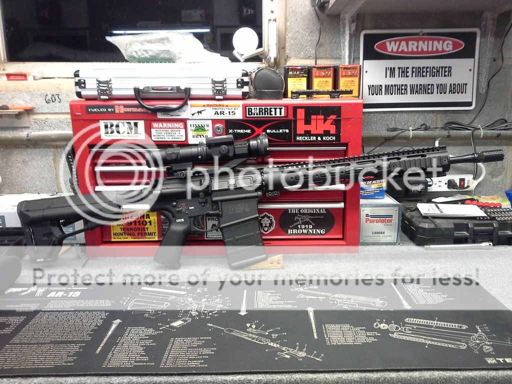

Here is also an mp10 I converted for a friend. Added this since you expressed interest in the mp10. Here is what it can become. 15" rail, strike fire 2, and 3x magnifer, claymore compensator, and several other mods.
