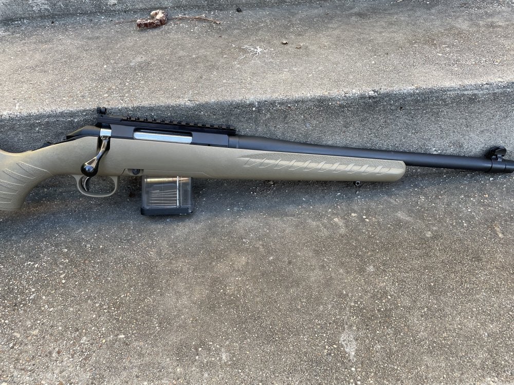

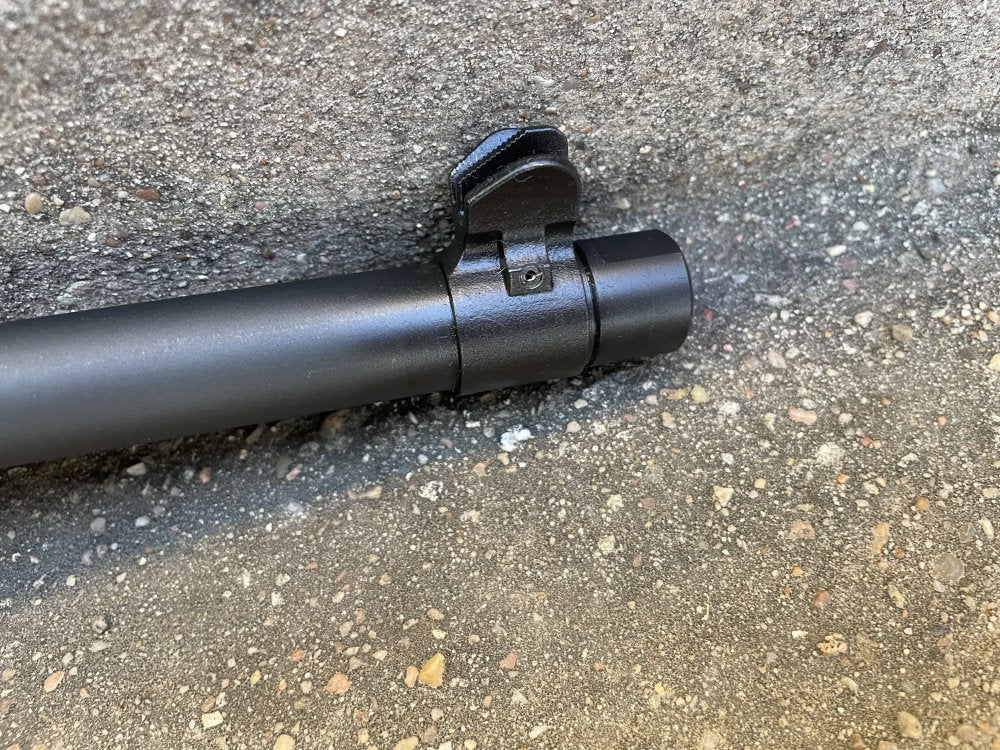

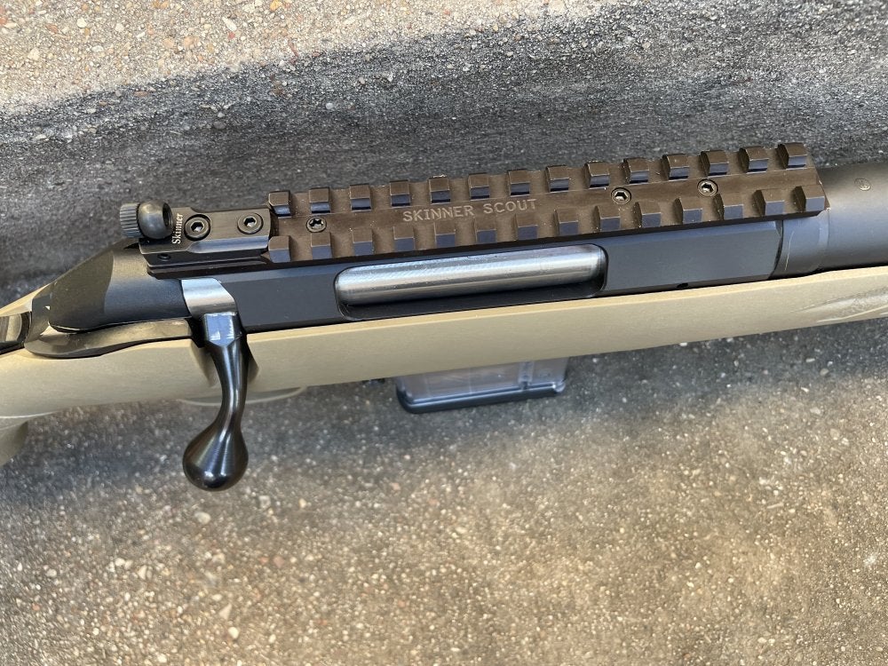

Resurrection of an old post for my first I know. It’s the reason I joined though.
I’ve learned that a Ruger gunsite scout front sight sleeves just over the front of a .300 aac barrel at 0.710” on my 300 aac at least. set with Loktite 620 then drill and pin as Ruger does. The rear is a skinner scout rail with the “scout” portion cut off as I don’t believe a scout scope is any good in todays world. I looked everywhere else and aside from buying from skinner since Dr. Skinner made me sights in his garage, Skinner is the only one I found that was clean, low, and fit the height measurement.
Thats my recipe for irons on an American Ranch. The 5.56 barrel I have is 0.670 at the thread protector, so, i‘m going to get a mini-30 front sight (0.625”) and ream it to size then do the same as above with it.
Hope this helps some.
